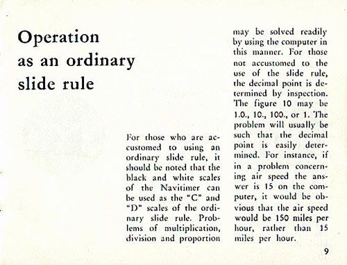

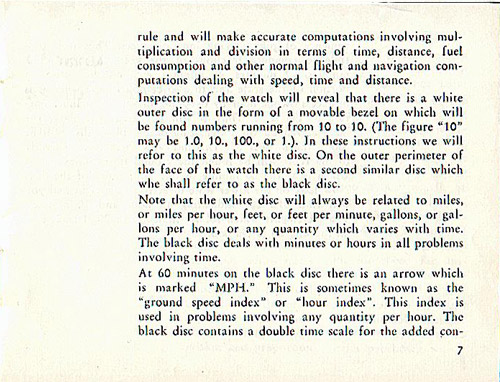

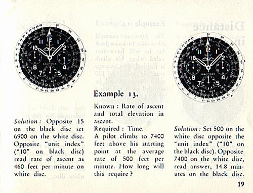

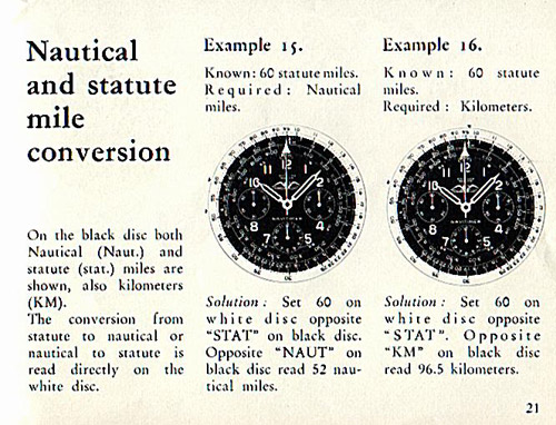

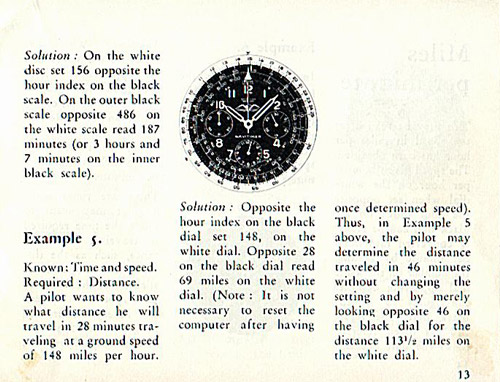

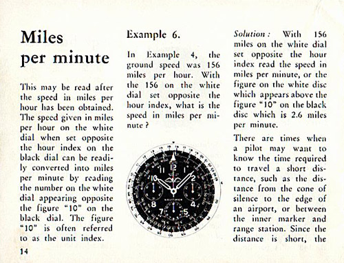

Breitling's Navitimer line is famous for it's slide rule bezel, but many people don't know how to use them. For those of you that don't have a slide rule manual with your Breitling, I've reprinted a copy of a 1967 Breitling Slide Rule Manual - It will be the same as using a current Navitimer Slide Rule.
