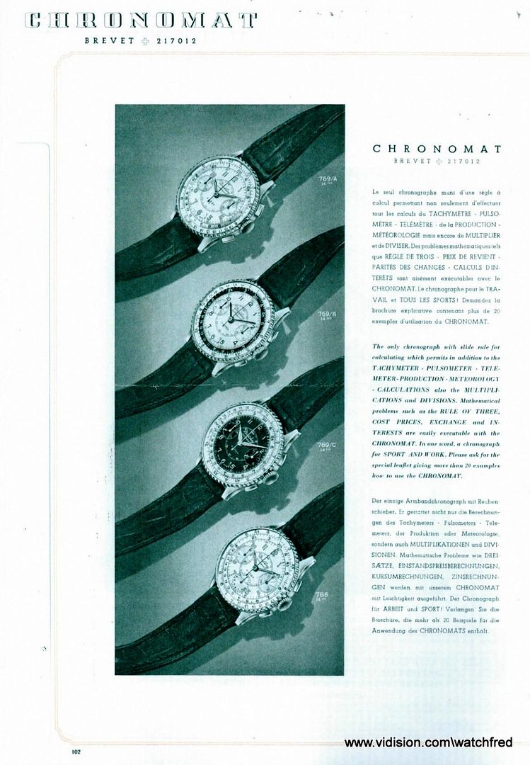

no reason to worry at all, Phil (saabreit) has actually posted a link to the Amman auction some weeks ago to present a very, very nice specimen of an early Chronomat 769 - the watch is in enviable condition; dial, hands and even the crystal seem all original and correct, also the serial number inside the caseback is right for these early variations - quite perfect, really. :bow:
the unsigned movement is absolutely fine for this period, we only see movement engravings from 1944/1945 onwards, some early pieces like yours and Phil's have Cotes de Geneve decorations, some do not; on later pieces we see gilded and ungilded movements, Breitling signed bridges and some with "Breitling Premier", both on SS and 18k Chrononmats.
The dial seems a little too perfect at first glance, like out of a time warp, but it shows no signs at all of refinishing for me, just an example of a perfectly preserved icon - congrats again.
Roff, this dial is correct and has been around from the "early days", did not see that variation on any 1950s Chronomat 769, both the 1944 and the 1946 catalog show this specific watch, the dial variation makes it a ref. 769/B.
here's the Chronomat page from 1946:

Moved to replica because that's what the section is for - requests for authentication, we do the same with contemporary pieces.
I had forgotten about Phil's Geneva stripes and good to hear that the non lumed dial is correct.

Thank you gentlemen for all the info, especially the images of the saabreit's model close in case number and that advertisement page.
