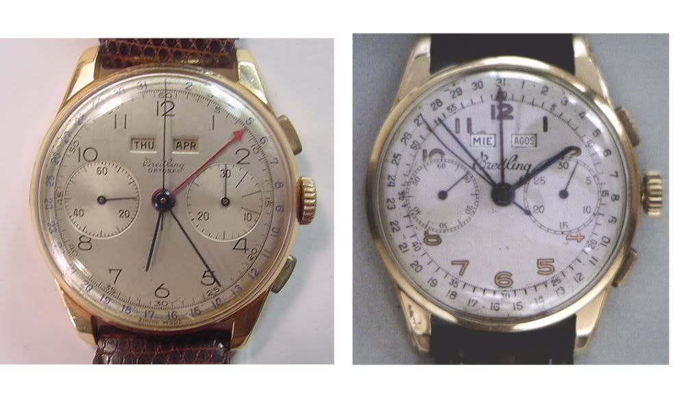

PostPosted: Mon Feb 13, 2012 3:55 am
Old post so forgive to bring this up again but the dial seems to be redone
Left a watch confirmed to be OK by Craig . Right the OP watch
-: no 'swiss made' on the dial
-: A-typical subdial markings
-: Breitling script strange,
-: No "DATORA" on the dial
-: Calendar numbers in black (typical in blue)
-: Datora's start with day '1' over the '12' , this one with '31'
overall the quality 'look and feel' just isn't there
PostPosted: Mon Feb 13, 2012 4:01 am
yep, reference pieces help a lot. like the one on the left very much ! :wink:
PostPosted: Mon Feb 13, 2012 4:07 am
It sure does help to have some real reference pieces !! :D
and the one on the left looks fantastic
