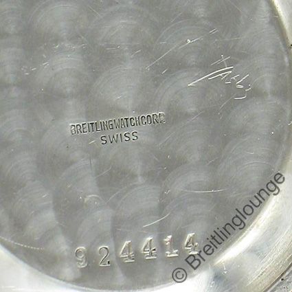

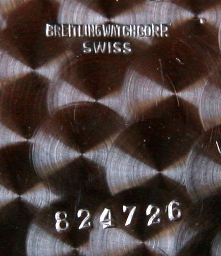

Here is an 824k with a non-logo AOPA dial with no spacer and Breitling Shock:
825,k with Breitling + Navitimer + AOPA with no spacer and Incabloc:
A 909k with spacer and non-logo AOPA + Navitimer dial and Incabloc:
909k with spacer but also Incabloc:
924k w/o spacer but still with Incabloc:
So maybe this is a definitive characteristic as relates to chronology. Or maybe Breitling produced non-spacer cases first but then had to scramble and redesign when they couldn't get enough 178s and went to the Valjoux movement (that could also explain the small bead bezels)? Maybe that thick-walled 825,k example points to this possibility?
But even if we grant that it is a chronological indicator:
If an 824,k 806 is really 924,k and 1959 because it has no spacer, why do these other examples from this early 900k range, some with spacer and some without, all have Incabloc? Note also the position of the "17-jewels" nomenclature next to the bridge on all the verifiably later models but not on the 824,k versions (it is on the upper left on the these):
(See, I looked at my 806 after all! :lol: )
And finally, if it is a mis-stamp and should read "924" why are the fonts of the stamps different between an 824,k and a 924,k which would have to have been stamped in sequence they are so close (these two would ostensibly be only 312 units away)?
So maybe, just maybe, the cases are from later but the backs are most probably not from the 924 SN range and mis-stamped by someone having a bad day at the machine. At the very least, we can put that fairy tale to rest I think. :wink:

SN --> dubious 1953er. Dial --> 1st generation. Luminous redone + all hands wrong resp. 2nd generation, painted white --> somebody 'created' this watch new --> Frankenstein watch.
No comment.
No comment.
No comment.
No comment.
IMHO not very realistic 'maybe's'.
No comment.
